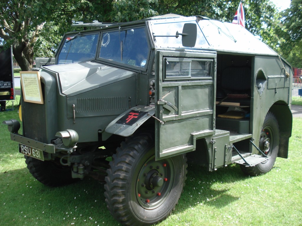

Here's a Morris Commercial QUAD.

On the 25 Pounder - Limber - FAT setup, they seem to be, for a 4wd truck, pretty capable off road all things considered. Obviously, reversing is a non starter, but the short wheel base allows a very tight turning circle.
