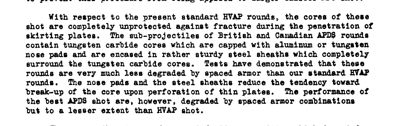

Peasant Posted June 10, 2024 Posted June 10, 2024 (edited) If we compare the performance of the early 90mm HVAP and the later, a higher velocity model, there doesn't seem to be any significant, if any, improvement in armor penetration (at least for conditions present in this test): Quote My explanation to this inconsistency is that the US tungsten core shatters when striking armour at higher velocity than ~1000m/s. Indeed, it doesn't seem to have a characteristic nose pad that seems to perform the same function as the AP cap in APCBC projectiles, that the later models of british APDS have: Quote Quote Edit: Quote Edited June 13, 2024 by Peasant
