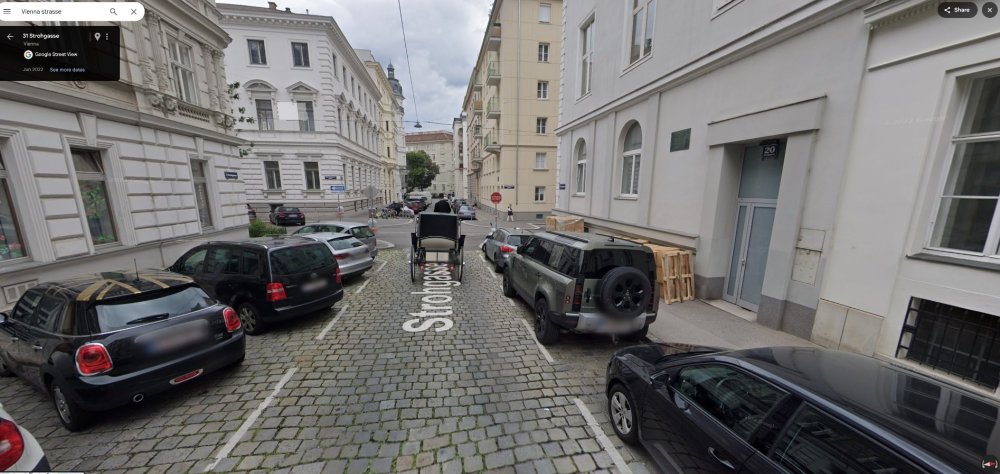

Ssnake Posted June 11, 2023 Posted June 11, 2023 1 hour ago, bojan said: One thing that could be gleamed from Ukraine that none has really talked about* is that classic airborne, jumping from the transport planes is simply dead as dodo vs even second rate AD network. Eh, that was professional opinion at Officer's School even in the late 1980s. Still, I see the Wiesel as the continuation of the Bren Carrier in that it provides mobility and fire support for light infantry. It doesn't have to be delivered by plane or helicopter to be useful. Wiesel is small enough to fit through narrow passages in mountain villages if necessary, and it can carry substantial firepower - whether it's a heavy mortar, an autocannon, or ATGM launcher. The relevant point is, it expands the capabilitry of light infantry in general, not just paratroopers, without a massive logistical footprint.
