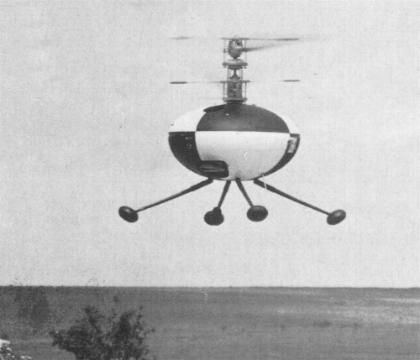

Stuart Galbraith Posted November 25, 2020 Posted November 25, 2020 From Westland in the 1970's. Ive actually seen this in Weston Super Mare Helicopter museum. http://www.starfiretor.com/AerialDrones/pix/27_UAVdrone_WestlandReconDrone_unrealaircraftqbranch.jpg
