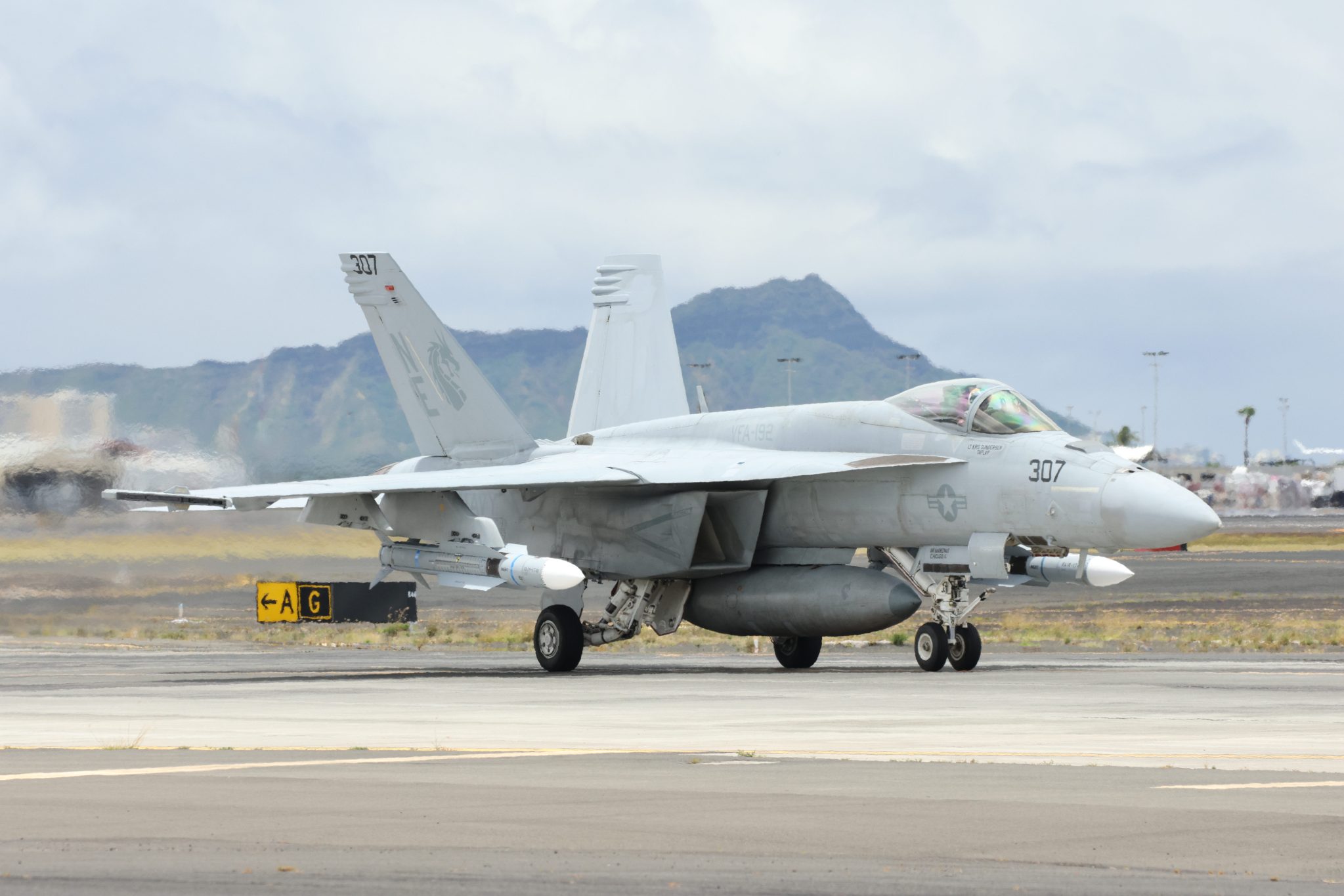

bfng3569 Posted July 3, 2024 Posted July 3, 2024 seems like as a good thread as any to revive for this... AIM-174... https://www.twz.com/air/aim-174-super-hornet-launched-variant-of-sm-6-missile-breaks-cover-in-hawaii
TrustMe Posted July 3, 2024 Posted July 3, 2024 It looks big and heavy. I wonder if the F16V could carry it?
Stuart Galbraith Posted July 3, 2024 Posted July 3, 2024 Tomcat called, says you have a job for him...
Ol Paint Posted July 3, 2024 Posted July 3, 2024 How many can F-15EX carry? And I echo Stuart's sentiment about the F-14. Cheney's decision to kill that bird is looking worse than ever. She may have been maintenance intensive, but big airframe plus big thrust has a lot to recommend it. It's ironic the LWF (YF-17) evolved into a F-15 sized airframe but with less thrust. Yet another example of false economies. Doug
