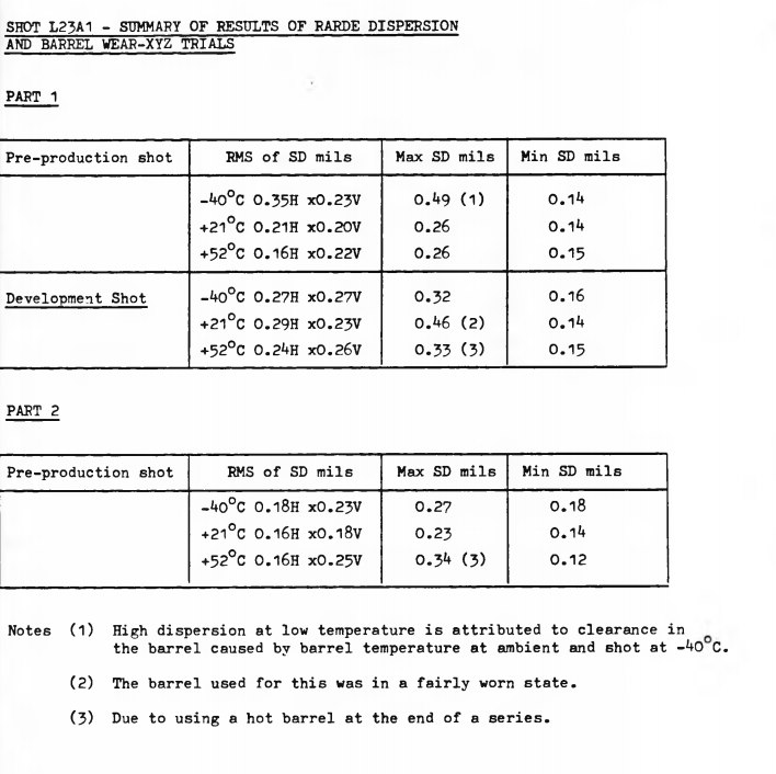

Stuart Galbraith Posted June 7, 2017 Posted June 7, 2017 This is interesting stuff. Did you ever find any dispersion data for L23?
Wiedzmin Posted June 7, 2017 Posted June 7, 2017 no, i tried find anything about L23, but... maybe report have name like "Exercise ....." but i don't know any "name" for such exercise

Wiedzmin Posted June 26, 2017 Posted June 26, 2017 This is interesting stuff. Did you ever find any dispersion data for L23?L23A1 i also have penetration, but don't understand it at moment, they fired at 130mm single plate, but get 482mm at PB and 435 at 2km
Stuart Galbraith Posted June 27, 2017 Posted June 27, 2017 (edited) This is interesting stuff. Did you ever find any dispersion data for L23?L23A1 i also have penetration, but don't understand it at moment, they fired at 130mm single plate, but get 482mm at PB and 435 at 2km That looks to be broadly 450 RHA, which is about what I thought it is. This is highly significant if true, because it means what I supposed L26 and L27 are might be true also. Hmm, good news. Or at least, better than Ive been assured it was. Thanks for that. Im not remotely technically minded to comment on how good this is, how does it compare to american 105mm rounds of the same period? Edited June 27, 2017 by Stuart Galbraith
