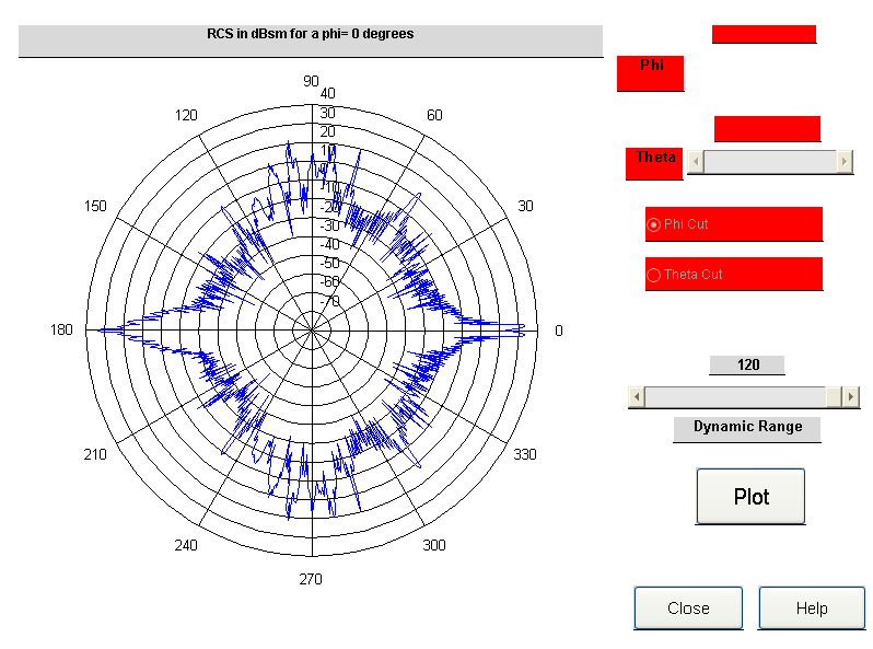

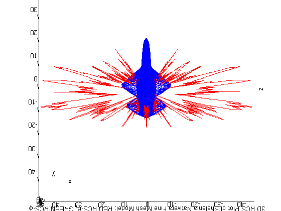

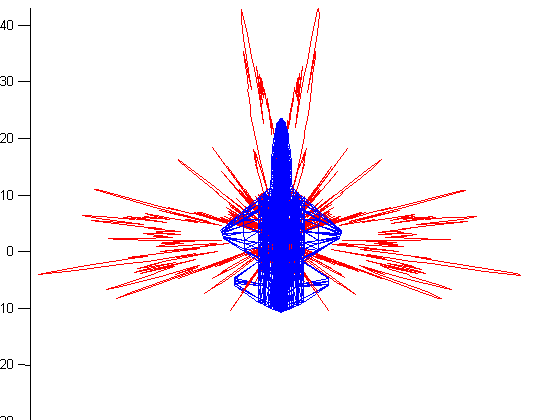

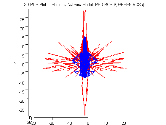

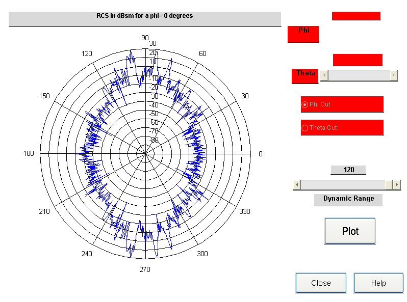

Stealthflanker Posted January 11, 2014 Posted January 11, 2014 Greetings everyone hmm have anyone try POFACETS software ? That's a software based on MATLAB used to predict RCS. It use physical optics as its basic laws Thus it has limitation that it cannot predict RCS other than specular (The mirror like return which is the strongest but also having extremely narrow lobe that it can only be "detected" if geometry permit) That also the very same ware that used by Carlo Kopp in his analysis to predict F-35's RCS. In my hand however.. Well i used it to polish my own stealth fighter. The Shelenia Nativera.. Roughly a single engined YF-23A herehttp://stealthflanker.deviantart.com/art/Shelenia-Nativera-271978773 I converted the 3D model of it to RAW format that acceptable for conversion to .mat file and start the fun. My goal was to optimize at least frontal aspect RCS against X-band radar based on this reference : The original model have well.. Since i make it for fun High frontal aspect RCS The aircraft representativehttp://i206.photobucket.com/albums/bb254/Superflanker_EVA/Facts%20and%20Figures/nativeranotoptimized.png The polar graphhttp://i206.photobucket.com/albums/bb254/Superflanker_EVA/Facts%20and%20Figures/NativeraNotOptimizedPolar.png Okay..optimization time.. so i changed some features in the mesh..like smoothing up the nose (reducing sharp edges and discontinuities) And the second mesh appeared.. http://i206.photobucket.com/albums/bb254/Superflanker_EVA/Facts%20and%20Figures/3Dplot0point3intervals.png The polar plot. http://i206.photobucket.com/albums/bb254/Superflanker_EVA/Facts%20and%20Figures/Polargraph0point3intervals.png Better but still there are two disturbing lobes spawned.. Something went wrong.. So time to optimize again. The last time.. i think i get it right http://i206.photobucket.com/albums/bb254/Superflanker_EVA/Facts%20and%20Figures/3Dplot0point3intervals-finemesh.png The mesh this time is much finer..ironed up some more discontinuities and sharp edges. The RCS ? http://i206.photobucket.com/albums/bb254/Superflanker_EVA/Facts%20and%20Figures/Polargraph-FineMesh.png I managed to get 0,01 Sqm at X-band Pretty fine i think. Yes the software has limitations but I think it's adequate for conceptual designs and optimization of design before first metal or composite is cut. Most importantly.. it's free (though the MATLAB is not) I would love to repeat Dr Kopp's analysis but i haven't make any F-35JSF models yet and there are still some uncertainties regarding on how the analysis was done (e.g Why Dr Kopp simulate only a part of the aircraft instead making a complete 3D model of it)
