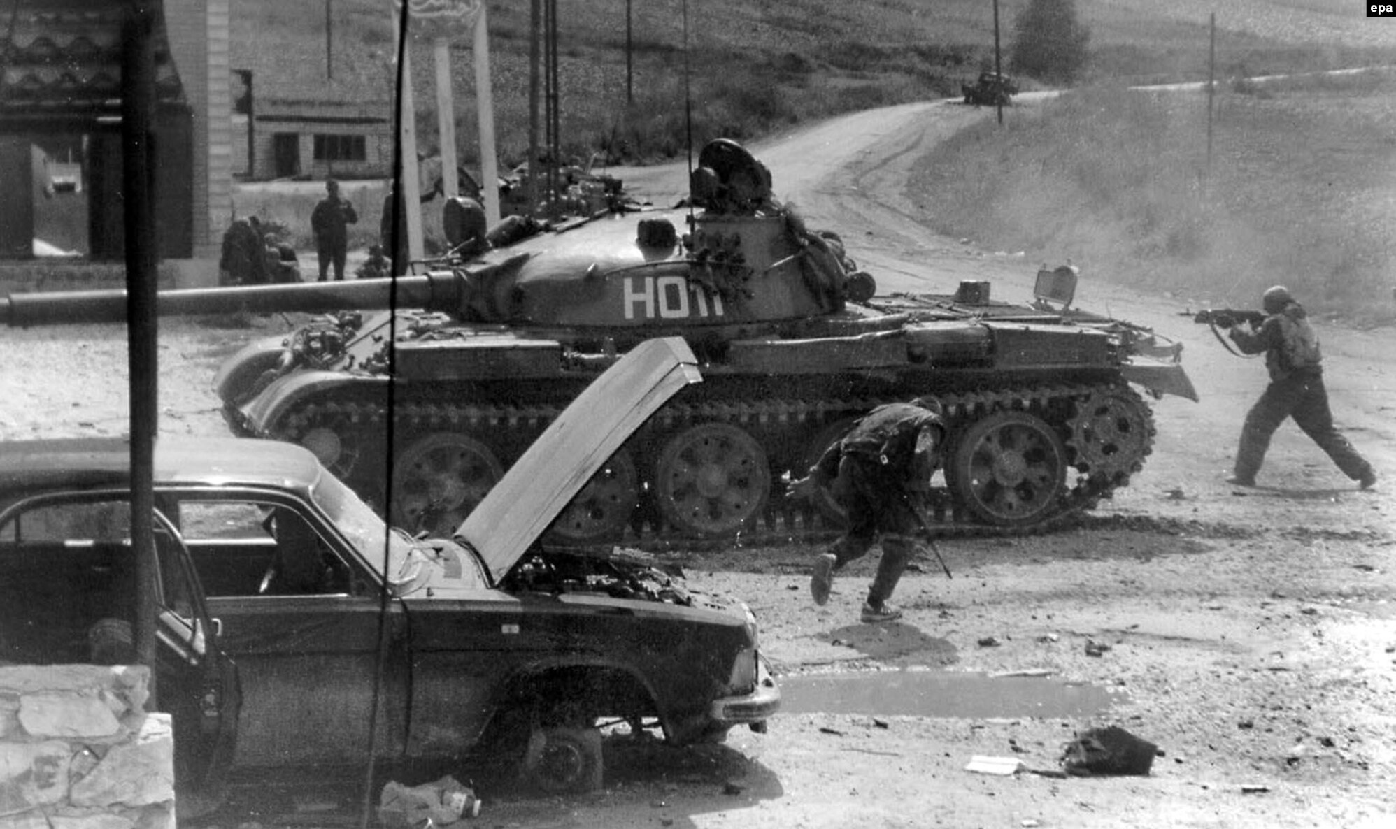

alejandro_ Posted June 9, 2021 Posted June 9, 2021 T-62 in the Caucaus https://www.rferl.org/a/the-second-chechen-war-in-photos/30185257.html?fbclid=IwAR16t5S4B78TAHHyD-U5Dvij51-K4629GSslYazoyrzM-yfrbzNkCMGxIEo
