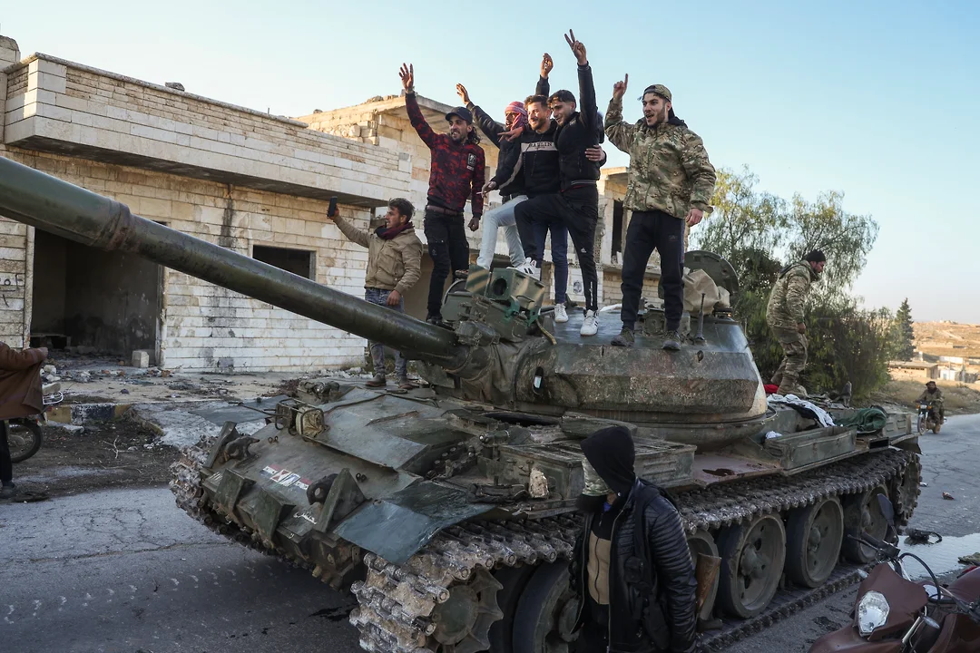

alejandro_ Posted December 3, 2024 Posted December 3, 2024 Captured T-62 in the town of Maarat al-Numan, southwest of Aleppo. Note 2 cameras over gun barrel, perhaps a thermal camera or one of the LRF is faulty... Photo: Omar Albam / AP
