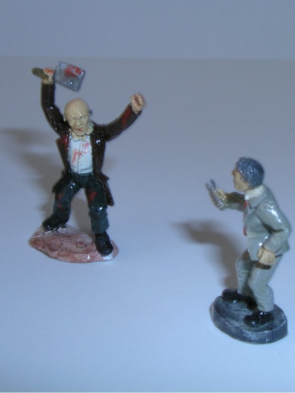

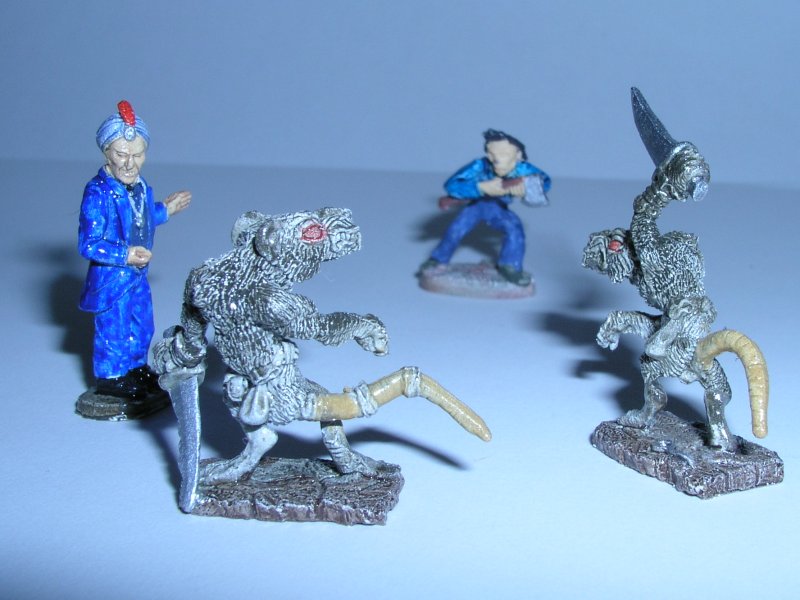

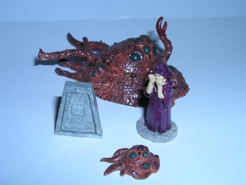

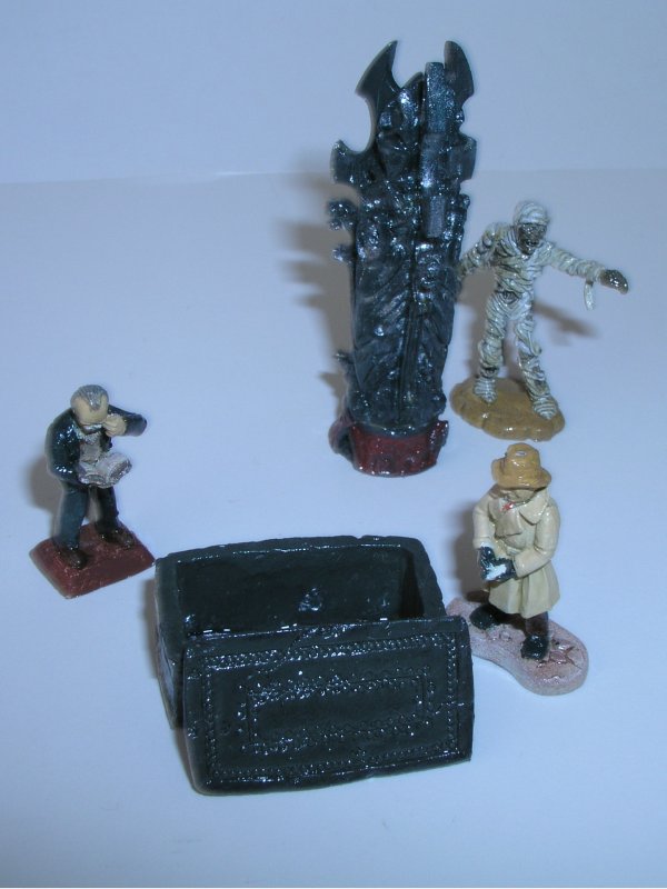

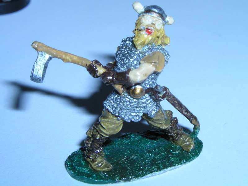

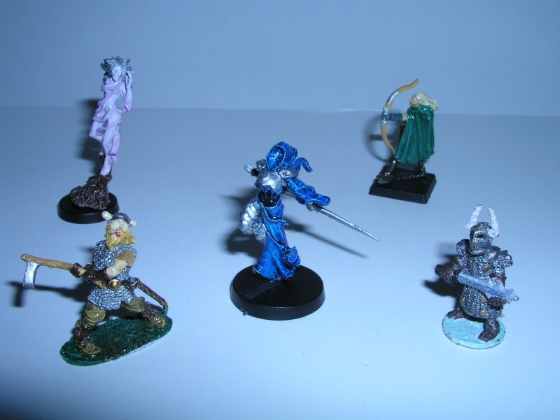

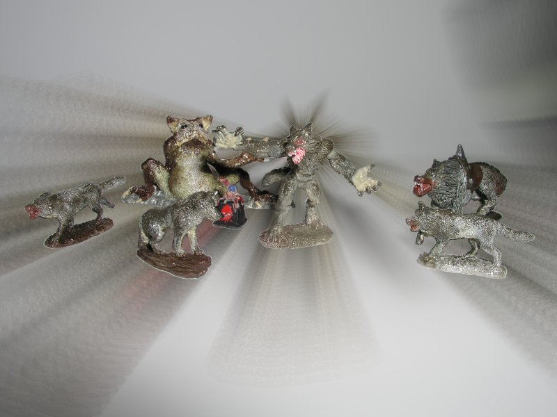

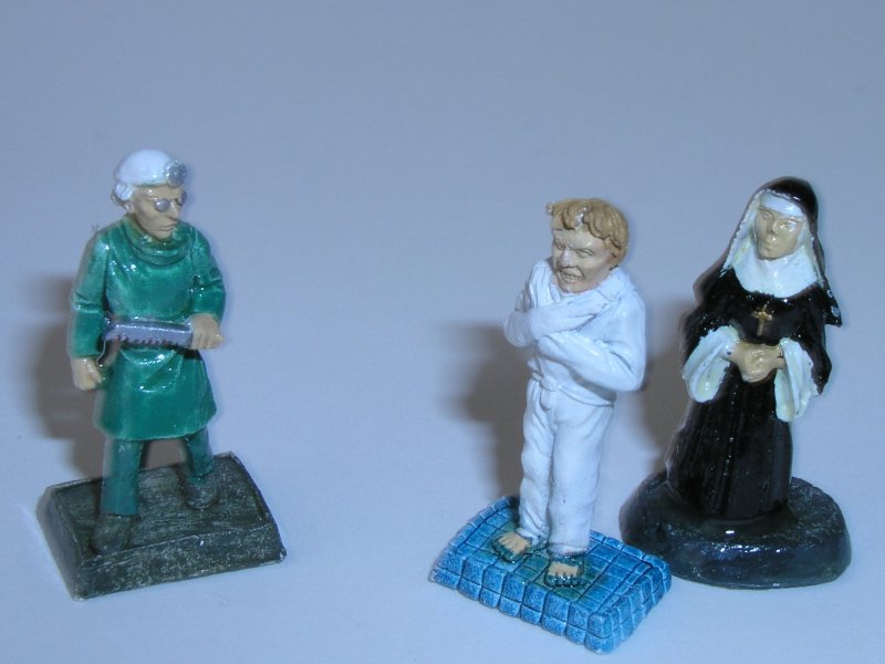

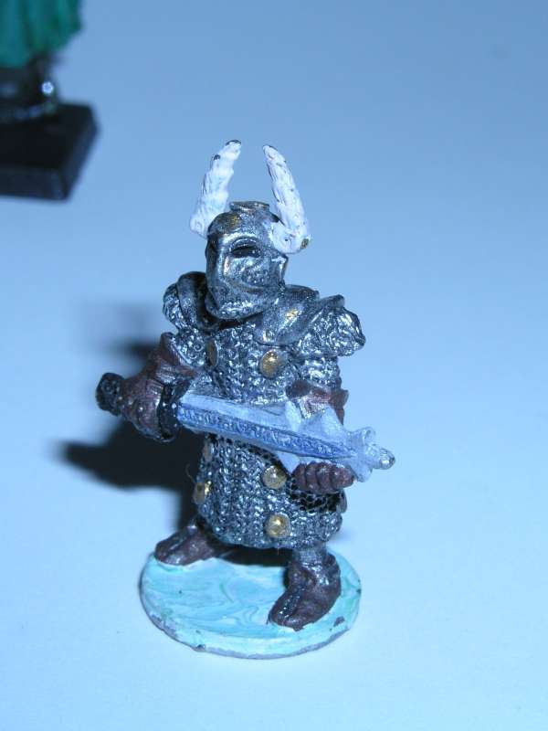

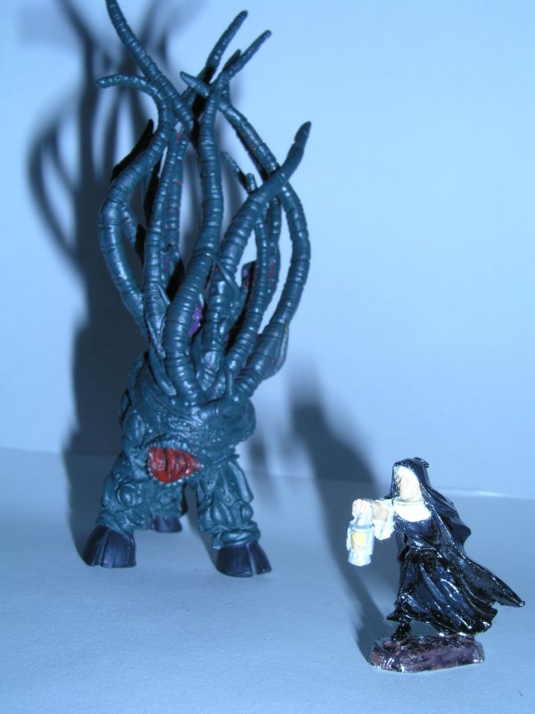

Ssnake Posted September 15, 2007 Author Posted September 15, 2007 ...Showtime! Well, let's see if I mastered the necessary ftp skills. The models here were photographed under quite adverse conditions. It's also important to realize that I all coat them with glossy clear paint for preservation purposes (they're supposed to be used in play, after all). Maybe I will take another set of photos, next time with tripod and polarization filter applied, and better lighting conditions. My desk clearly isn't the best spot. (Click for large Version)Well, there comes a time when investigators may stumble into some quite worldly trouble. (Click for large Version)To their amazement, Prof. Farnsworth and the assisting PI Fjodor F. Fjodor found the sarcophagus opened - and the mummy apparently stolen. (Click for large Version)Dr. B. Rainsaw and assisting Sister Doughlov visit the prospective client, former Prof. Farsworth, suffering from severe schizoid psychosis. His bizarre fantasies seem to circulate around undead Egyptian priests - electroshock therapy did not yield tangible results, so a lobotomy is now considered. (Click for large Version)Notorious cultist T. H. Rodwobbler Mangrove orders his troupe of rat men to attack the surprised lumberjack who accidentally disturbed the summoning of the Great Old Yoghurt. The sight of rat people unfortunately creates a mental trauma in the mind of the unsuspecting woodcutter. The end of the story is unknown. (Click for large Version)The expeditious retreat of Sir Archibald requires a sudden change of plans as the other end of a surprisingly large, purplish undeground dweller cuts off his egress route. (Click for large Version)To his dismay, the Grand Mufti of the Order of the Purple Dusk fails to recall the bind order after successfully summoning the Shoggoth. "Klaatu, Verata, N---!" (Click for large Version)Sister Maria N. Lostynwood on the way back to the monastery. The forest of Goatswood however isn't just home to fox and bunny. And the Dark Young of Shub Niggurath is hungry tonight. (Click for large Version)Perplexed the Great Tsathoggua welcomes his latest visitors - a wolfpack and its leader (homo lupus lunis), apparently caught in a random fold of subspace. That's got to be that 'Woodstock' about which Mom and Dad are always talking..." the young werewolf thinks.

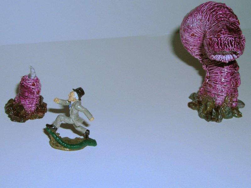

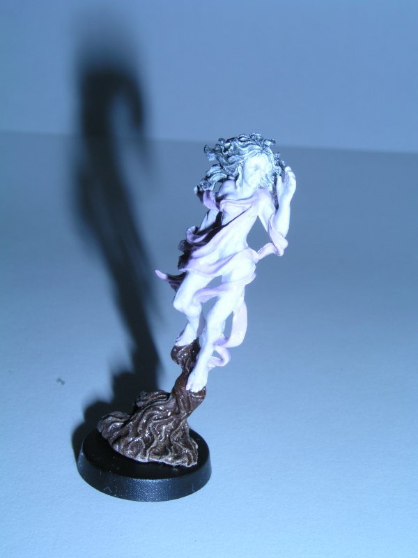

Ssnake Posted September 15, 2007 Author Posted September 15, 2007 Last part for now. The egyptian collection by and large is still in development, as are a variety of frog men, deep ones, and harmless villagers. Also, the bigger monsters take some more time to paint in adequate detail. Notice that I don't use any tools but standard 0 size brushes and enamel paint. I do glue the figures on larger bottle caps with hot glue - painless to remove and reasonably easy to handle. (Click for large Version)In another rather bizarre encounter, a notorious axe murderer, an animated knight's armor, a banshee, an elven archer, and Sir Nadsin Steele stumble into each other. Short of imagination they threaten to kill each other. Hilarity ensues. (Click for large Version)Detail shot of the aforementioned party. Well, a more or less traditional Banshee. The photo actually isn't of best quality, but then again it makes her look even more like a supernatural entity. (Click for large Version)Detail shot of the aforementioned party. One of the few original D&D figures I ever played - here a (supposedly ambidextrous) axe barbarian; I couldn't find a miniature that wasn't looking suspended too far from reaility and still had two axes in its hands. (Click for large Version)My first pewter miniature, ever. And still, I think, one of the best looking ones. Not that I ever incorporated Sir Nadsin Steele in any kind of D&D session or other fantasy RPG. Actually he doesn't fit anywhere, and his "sword" is an insult to any historically oriented game. But still, he has a kind of a kick ass attitude.
