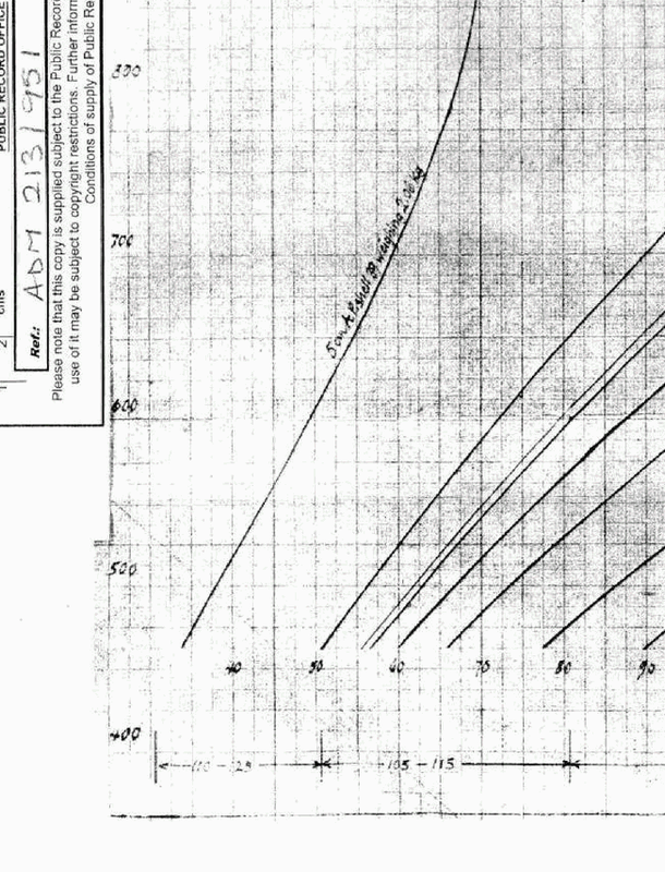

Wiedzmin Posted June 19, 2024 Posted June 19, 2024 (edited) Just some random german doc from bundesarchive , available on-line Edited June 19, 2024 by Wiedzmin
alejandro_ Posted June 26, 2024 Posted June 26, 2024 On 6/19/2024 at 11:16 AM, Wiedzmin said: Just some random german doc from bundesarchive , available on-line Thank you, it shows the advantage in penetration of the 128mm Pak 44 over the 88mm Pak 43. Note vertical axis showing hardness. It is a shame no more data versus different slopes is included, as the 128mm round should have the advantage.

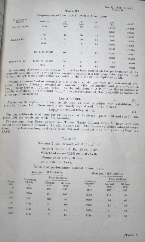

Peasant Posted May 4 Posted May 4 (edited) Here are some pages from "SUPP 6-475A Ordnance Board Proceedings Q1782-2094 Jan-Mar 1944" relating the results of british testing captured german 5cm guns: Quote And here is the german data for this shell: By plotting both data sets on a single graph, we get the following: As expected, given the more restrictive german penetration criteria, the performance obtained by the british is somewhat higher, albeit not by much, except at the very highest thickness tested. It is also interesting to note that despite the efforts of german designers to ensure a reliable detonation behind the plate, the performance of mass produced shells tested here is severely underwhelming in this regard. Edited May 4 by Peasant
