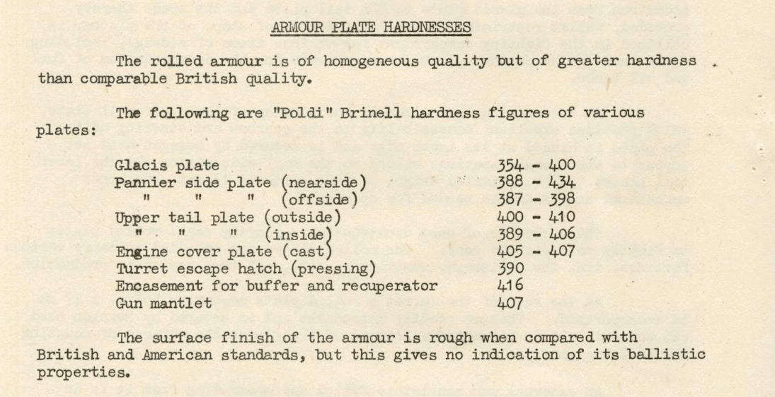

Peasant Posted August 15, 2023 Posted August 15, 2023 From the "Preliminary Report No.20: Russian T/34" from the brits. From what I've seen in the documents of the time, the specs for T-34's rolled plates called for Brinell dent diameter of 2,9 - 3,15mm (375 - 444 BHN). As we can see here, all plates but the glacis meet these specifications.
DB Posted August 18, 2023 Posted August 18, 2023 Is the variation across the samples typical for the era? It's a bit difficult to get a feel for the consistency without knowing how many samples of each plate were measured, and what values a good quality process would yield,. One might assume that the specification range was considered achievable for large scale production, so might be a suitable definition for "good quality". Presumably the higher hardness for the Russian plate is a design choice, rather than a capability gap.
sunday Posted August 18, 2023 Posted August 18, 2023 They could have choose to have a less hard glacis in exchange for more tenacity.
bojan Posted August 18, 2023 Posted August 18, 2023 4 hours ago, sunday said: They could have choose to have a less hard glacis in exchange for more tenacity. Don't forget that T-34 glacis and upper side hull requirement was protection vs 37-45-47-50mm, and vs those projectile s higher hardness was good thing. Then war started and whole thing just kept staying the same, first not to interrupt production, and second as there was no way to really uparmor T-34 hull and keep it reliable (front wheels were already overloaded in T-34-85 version) there was no point in changing anything about front armor and delaying production.. KV-1s., whose protection scheme was intended vs 75-76mm field guns firing AP, used softer armor plates. T-34M prototype, whose 60mm@60deg glacis was intended to protect vs 76mm field guns firing AP @ 250m was supposed to have lower hardness armor plate, probably same as KV-1 did.

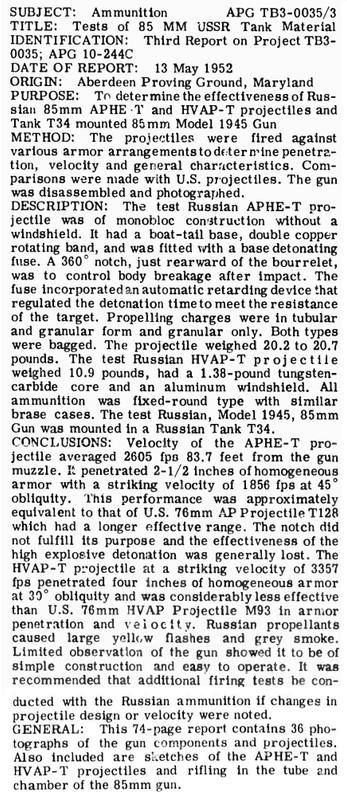

Peasant Posted September 26, 2023 Posted September 26, 2023 On 12/1/2006 at 2:05 PM, Guest bojan said: 85mm ZiS-S-53 (from T-34/85) firing AP, HVAP and HEAT Vs Sherman: BR-365 AP penetrates glacis @ 1100m BR-365P subcaliber penetrates glacis @ 1200m Both rounds penetrate side hull at any efective range... BR-365 AP penetrates turret @ 1000m BR-365 AP penetrates turret @ 1250m Both rounds penetrate side turret at any efective range... Interesting - almost same performances as 75mm PaK save shorter range that BR-365P subcaliber penetrates front turret compared to PzGr.40... BR-367 AP, BR-367P subcaliber and BK-367 were tested also but I have no info about those tests. I would like to point out that the 85mm AP shell used here is almost certainly the BR-365K. Here is my reasoning: Quote S.V. of 1856fps is equivalent to a distance of 1450-1500m for BR-365K shell and ~2600m for the BR-365 blunt shell. Neither of these number match perfectly the data from Yugo trials but one is much closer than the other.
