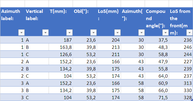

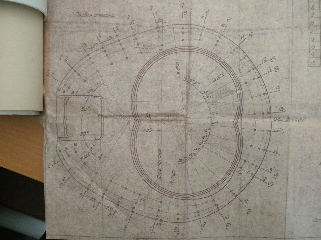

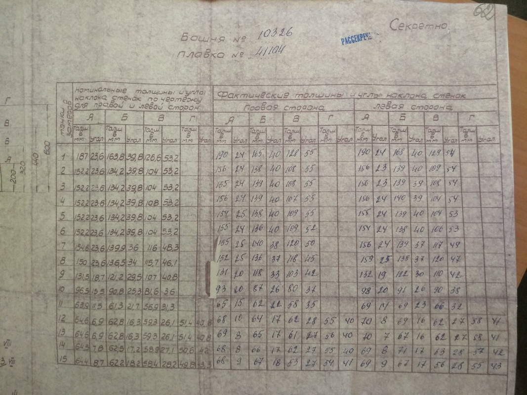

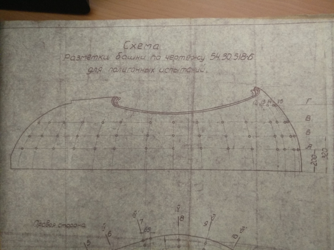

Peasant Posted November 15, 2022 Posted November 15, 2022 (edited) Dont hold it against me if I revive this old thread, as I have some interesting info to add: As you can see, the frontal armour of a T-54/55 is much stronger than the commonly quoted figure of "200mm". This explains why the german Kwk43 and the US 90mm HVAP shells had trouble defeating this target. Edited November 15, 2022 by Peasant
